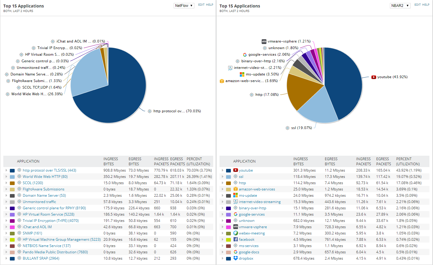

This is showing NetFlow and Nbar2 details. Same Interface, same time-frame. All I did was flip the Dropdown at the Top Right from NetFlow to NBar2 to show how much more detail you can see with NBar2.
PURPOSE: Showing how NBar2 can be configured, using the NBar2 Protocol Pack to see more details as to the sites used.

The picture above is based on the configuration in the Administrative Guide utilizing the NBar2 Protocol Pack available for the IOS the router I was using.
