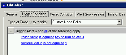

Created a property monitor of Custom Node Poller in Advanced Alerts to set up an alert that triggers when a VPN tunnel is down.
I applied OIDs to a Fortinet node, for the tunnel state, fgVpnTunEntStatus (1=down or 2=up) as Raw value, Format: none, Get, and for the tunnel names to pass, fgVpnTunEntPhase1Name, and fgVpnTunentPhase2Name both as Raw value, Format: Text, Get

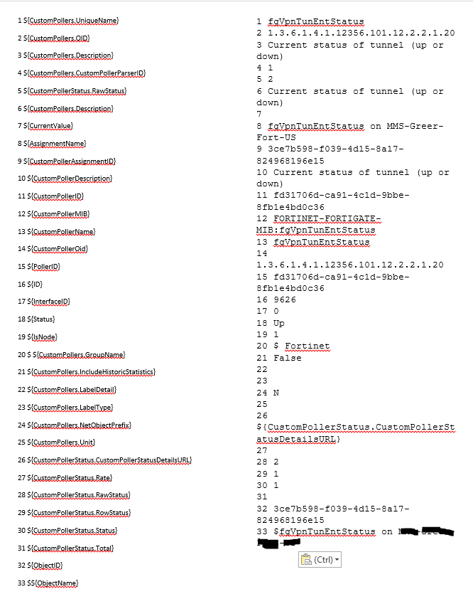

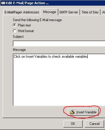

I created an alert to simply pass as many variables as I could to see where to find how to include the (fgVPNTunentPhase1Name), and to determine which values are available to build the alert.
It triggers properly, but can't figure out how to a.) include the tunnel name variables to pass into the alert message, and b.) which is correct variable to pass showing the tunnel status (i.e. 1=down).In order to trigger the alert, I set condition to not equal to down, since the tunnel being tested is up, so I assume the '2' values in #5 or #28 would be correct for that? How do I get the Tunnel name out from a variable?
Here's the list of variables that were available, followed by the corresponding output of the actual alert.
