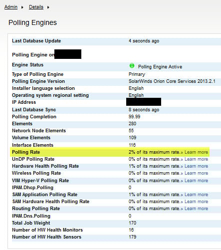

You can check you polling engine capacity by going to Settings > Polling Engines from the website.
For each polling engine, there will be a 'Polling Rate', this will be a good representation of your server's capacity for polling at the current intervals. (There is a more detailed explanation of this metric under the 'Learn More' link.

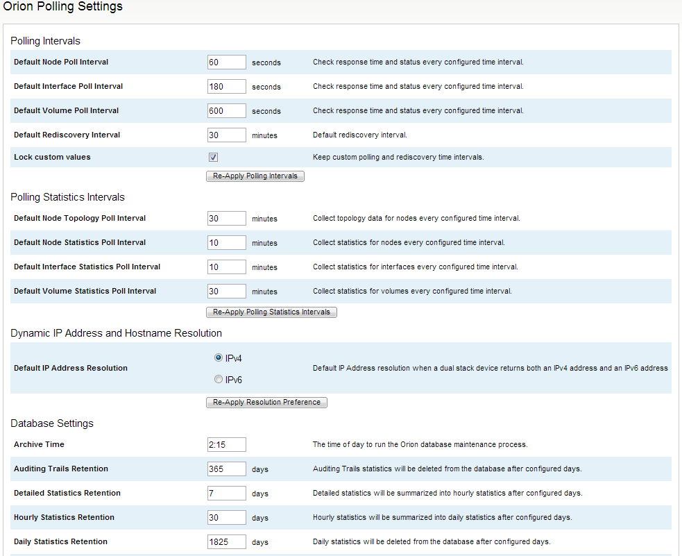

My settings may be different from typical user, but here are they in case you're interested:

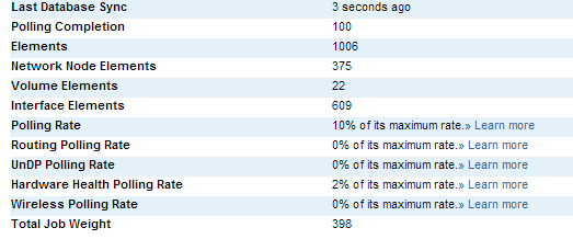

My polling engine looks like this:
So, as Zackm told, everything depends on what you want to see. Some may want to poll everything in every 10 seconds period, but doesn't need history more than few hours. Someone is interested in long period trends only...
