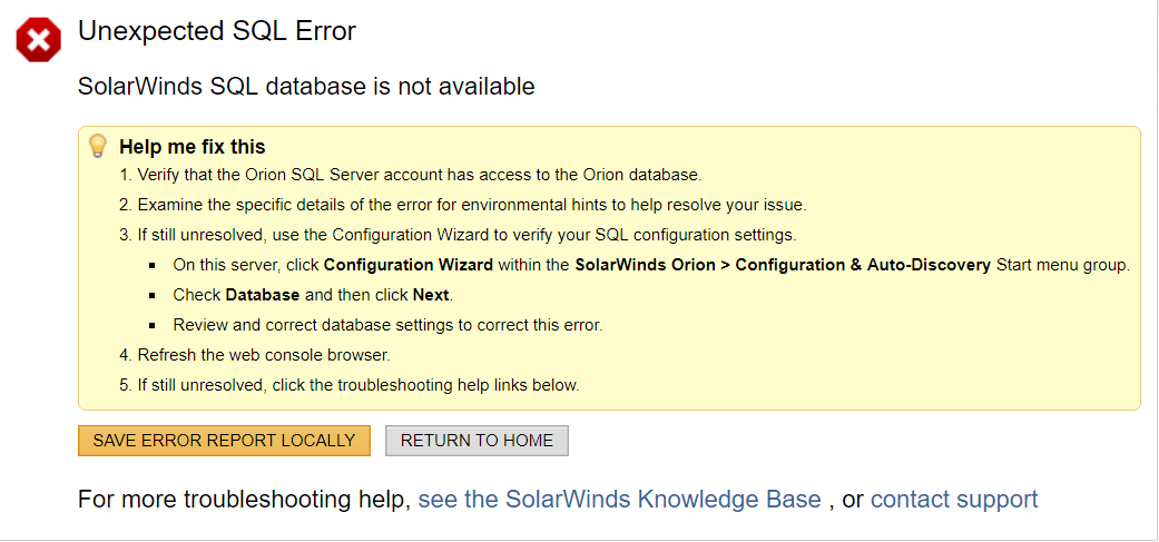

hi, need help , after make maintainence in system , the database files got corrupted , especially SolarWindsOrion.mdf & SolarWindsOrion_log.ldf .

The Database will contain all of your configuration including all the managed nodes and historical data. It is very simple to create a new empty database and get the system up and running again.
On the Orion server, open the "Configuration Wizard"
You will have 3 options, for Website, Database, Services.
Follow the steps in the wizard and when prompted to use an existing or new database, choose new.
Click next and review the remaining screens.
The process will likely complete in 10-20 minutes. Here is an example SolarWinds NPM Test Installation Test Video - YouTube
The error report will often tell you additional information... the database may be fine btw.
Try running the config wizard, it should help you sort the issue out, the database could be ok run the wizard.

Hi diamondtouch you need to follow the instructions posted above by tony.johnson and run the Configuration Wizard selecting "New Database" this will start you with a fresh database.
