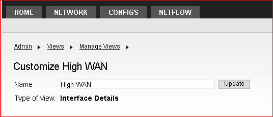

1. Open NPM > Settings > Views > Manage Views
2. Click Add
3. Name it, use the drop-down for Type of View to select Interface Details
4. Click Submit and the new View's configuration option page is displayed.

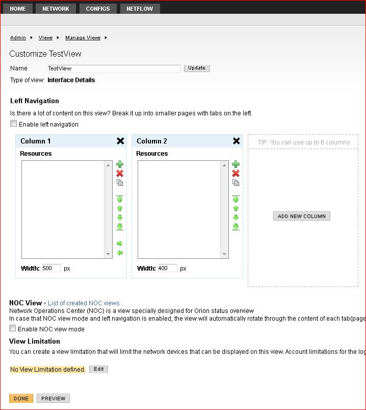

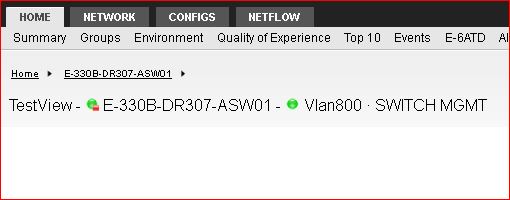

At this point I can add Resources, or even leave them all blank. But when I click Preview, or Done and select the view to see it, I get a view showing a Node.
I can click Customize Page on the View, but it just goes back to the screen where I can add or remove resources--nothing about the header and sub header can be adjusted.

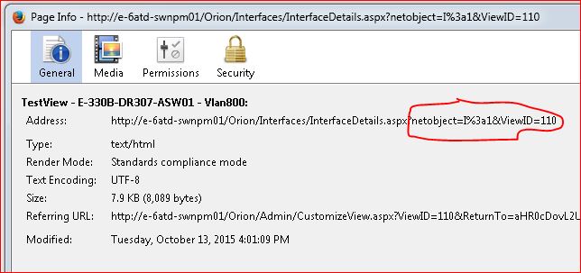

If I view the Page Info I see the Node name in the top, and an address with a net object referenced:

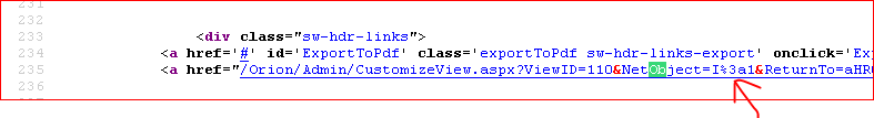

When I view the page source I can find that net object referenced several times there:
A different Net Object is referenced here:
