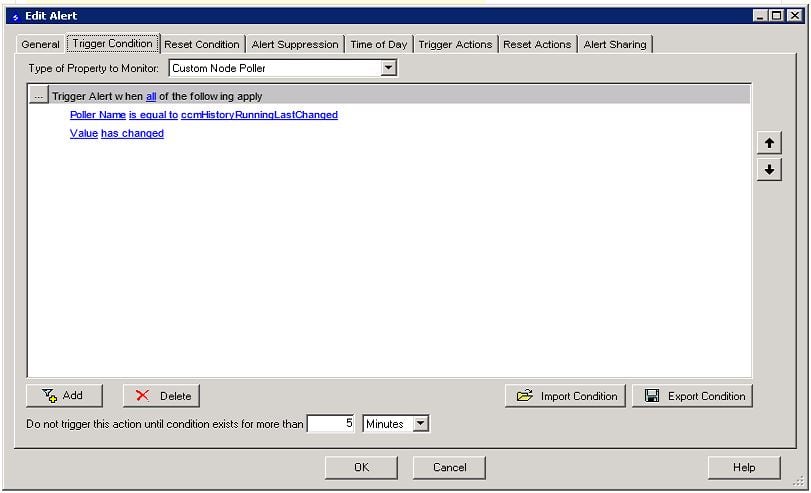

I have a couple of alerts I want to use the "has changed" option. Here is the alert trigger :-
The value is a number and I have tried both value and numeric value, but the alert doesnt trigger. Also, what should the reset condition be?

this the equivalent SQL query of an Alert for Type of Property Custom Node Poller and using for "Value has Changed"
you cannot use "has change" as it clearly states on the equivalent SQL query that it is pulled on Nodes table and not on the Custom Poller tables. You have to use like Numeric Value is greater than, or equal, or less than.
Yes, I saw that too, but why is there an option for "has changed" for other values if it wont work for anything other than the 3 values?
That is also a question i have since i used Solarwinds and I was also using it when I still do not understand how it is used. But i learned it the hard way.I would guess that the Type of Property Custom Node Poller or Custom Node table Poller alert - queries also some information on the nodes table like the Node ID, since that alert template needs the Nodes table, most probably other aspect is visible to this type of property but it does not mean that we can use it.
