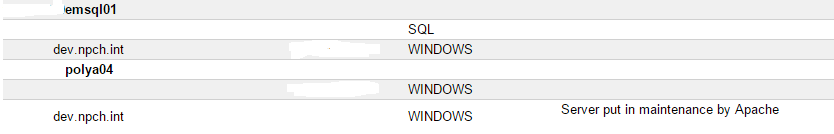

And we configured the table to Group results by NodeName from the query above. The resulting data looked like the following (minus the redacted part) -- notice that the nodes are not distinctly grouped.

Notice that the nodes are now grouped together by the common NodeName. The change was the LOWER() function in the query.
