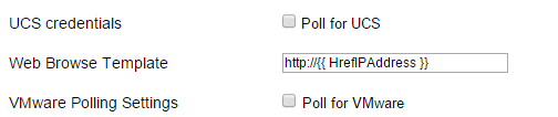

I may have stumbled on a bug with the Additional Web Console. When trying to add a new node the Cisco UCS options are missing.
Steps to recreate:
- Log into the Additional Web Console.
- Click Settings > Manage Nodes > Add Node.
- Type in the IP address of the UCS node, choose SNMP/ICMP,
- The Cisco UCS option is missing.
So on the Additional Web Console server the VMware polling settings are there but not Cisco UCS options.
The good news is that our primary poller server is still running the Orion Web Console and the Cisco UCS options do show up there. On the primary poller server:
- Log into the web console on the primary poller server.
- Type in the IP Address of the UCS node, choose SNMP/ICMP.
- The Cisco UCS option displays normally. We are able to move forward with adding in the UCS node.
