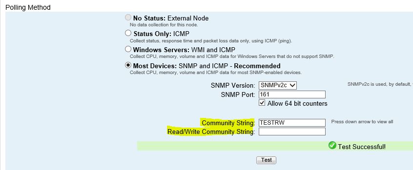

I have run into an issue where NPM does not detect SNMP RW community on devices as a "Read/Write Community String" when a network sonar discovery is done. NPM only detects the community as a "Community String"

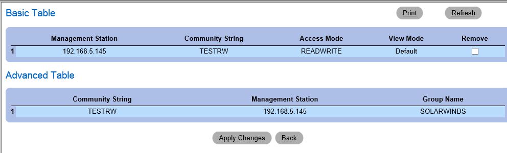

The community is set on the device as READWRITE, in this case a DELL PowerConnect 6248 Switch
It happens for other devices as well such as APC Rack PDU
This is causing a problem as I have to manually enter the RW community on each device before I can use the write features of other Solarwinds application (e.g turn off a interface in UDT)

I would like for NPM to discover the Read/Write Community String during network sonar discovery.
