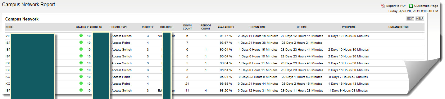

Micheal is right. Also if you need the sysuptime (hardware up time) you can get it by assigning corresponding SNMP OID to every device via UnDP. Then you have to convert the result in milliseconds to human readable format. Some friend of mine create me a report including sysUpTime (OID 1.3.6.1.2.1.1.3.0).

I know this one is an old thread, but I think your report looks very informative.
If you don't mind, would you please share the SQL script for this report/view because I am not pretty good with SQL. Thanks.
