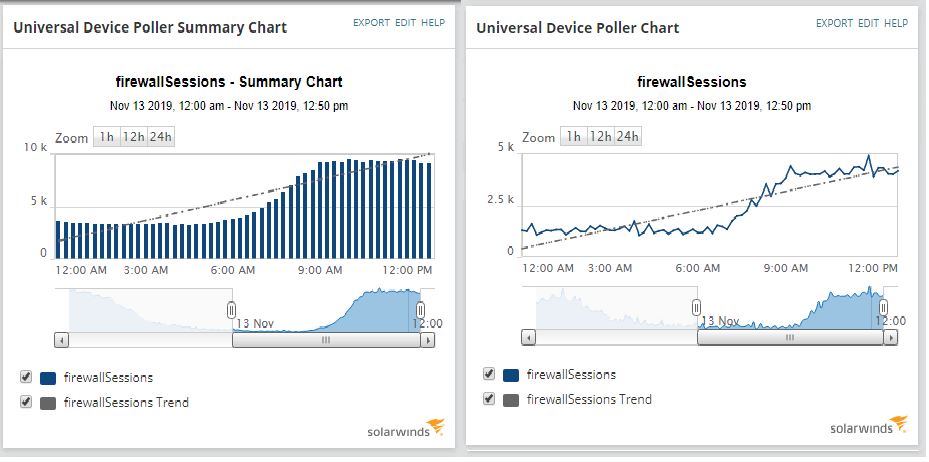

Here's an example of NPM polling an interface once every ten minutes over twenty-four hours:
Compare the same exact interface bandwidth information polled every ten seconds with an Engineer's Toolset Bandwidth Gauge set to display a historical graph:
Comparing today's information (the right half of each graph), NPM missed the 710Mb/s spike. It reports bandwidth utilized today was between 70 Mb/s and 100 Mb/s.
But the Toolset Bandwidth gauge shows most of the day was spent between 100 Mb/s and 200 Mb/s.
