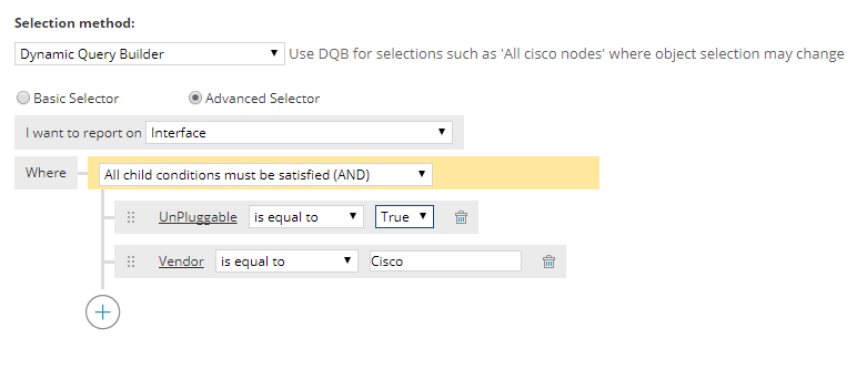

I tried creating the following trigger condition which doesn't work:
After logging ticket 00439660 with tech support, I was advised that it's not possible to run this via the GUI with two UnDP's and two AND statements (OR statements would work but do not meet my requirements). As such, I have asked for this to be raised as a feature request.
