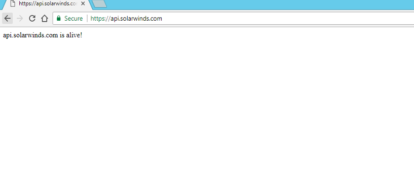

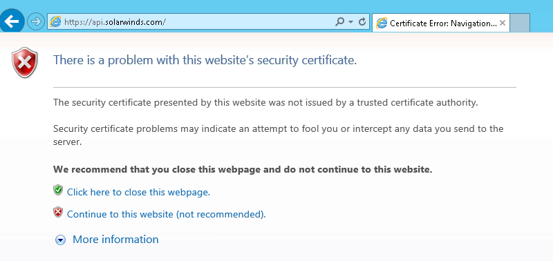

Like the title says, I'm getting "Unable to Connect to the Internet" when running the NPM 12.2 Online Installer on our Windows Server 2012 R2 box. When I choose "I've fixed the Connection problem" and click "Retry" it pops up with the same error and adds the message "Unable to connect to the internet. A connection could not be opened to https://api.solarwinds.com". If I browse to that URL in Chrome or Internet Explorer I get the message "api.solarwinds.com is alive!", so that site is definitely reachable from the server...

- solarwinds.com is added as a Trusted Site in the Internet Control Panel (along with amazon.com, amazonaws.com, and a bunch of other sites)
- While we do have web filtering in the company, it only blocks malicious sites and definitely does not block solarwinds.com (proven by the fact that I can go that api.solarwinds.com URL just fine).

System.Net.WebException: The request was aborted: Could not create SSL/TLS secure channel.

Proof that the server can indeed connect to api.solarwinds.com just fine:
