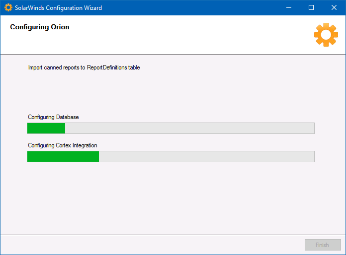

Whenever I update solarwinds, Orion installation takes 40 mins on 'Import Canned reports to ReportDefinitions table'.
Why below steps takes too much time, is there any way to make orion installation faster
Good news! Today's release of Orion Platform 2019.4 Hotfix 2 includes a change to how we handle the import of reports. You should notice a significant improvement with this update.

If you look in the configuration wizard logs, there are a lot of configuration steps that are happening behind the scenes. I'm happy to let you know that over the last few years we've already make a lot of investment into how we deploy and upgrade installations for a dramatic speed improvement, starting with the SolarWinds Feature: SolarWinds Orion Installer - SolarWinds Worldwide, LLC. Help and Support and most recently centralized upgrade Orion Installer 2.1 feature: Centralized Upgrades - SolarWinds Worldwide, LLC. Help and Support We are continuing to invest in the simplification and speedup of this workflow, so your upgrades should be getting better and better as you get closer to the latest versions.

As part of our continued efforts to improve the configuration wizard and reduce the time taken to install/upgrade, with the release of the Orion platform 2019.4 the OOTB reports have been migrated to the web-based report writer.Orion Platform 2019.4 Release Notes
