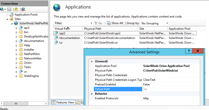

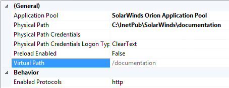

I tested this on 2012 R2. Here's what the properties look like:
They're pretty similar to what you have save for using SSL and a different port.

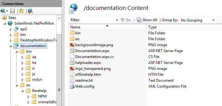

Here's the content view, in case we're missing some files:
I'm pretty confident that you can use this with a different port. I am less confident that you can use this with SSL. Is it possible to try this without the SSL binding to see if that's the issue?

1. On your first graphic you seem to be using the default Solarwinds Orion Application Pool but using the /documentation as the physical path for the Solarwinds Application.
2. Are there suppose to be separate Application Pools and Websites?
I have all the files as you have listed, which is good. Right now I just want to stick with http. HTTPS will be next, once I know it is working.

1. Yes. We are running multiple applications under SolarWinds NetPerfMon. They are all using the same application pool name with different physical paths.
2. I'm not sure I understand this question, but from what I know, every app under the SolarWinds website shares the same app pool.
