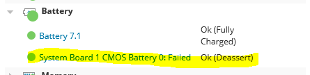

And (for example) for Battery:-

1) Is this now the new normal with Hardware Sensors? i.e. where before we would see, for example, Battery and its status we now see a "sensor" for every possible "state" of the battery (or disk or fan etc.)
2) If the above is correct (and what we are seeing is not a bug/erroneous), would disabling these sensors affect "seeing", alerting etc. for the actual component that we want to monitor? And, if all sensors were disabled, would we "lose" the actual component icon/status? (This last one because for some things there appears to be lost of "I am in error" sensors but no specific "I am general component sensor with x status").
For example:-
If I disable all those - would I still have a CPU component and would it reflect an issue if there was one (with one of the disabled sensor statuses or a general "CPU" status that (presumably) would be set from the other sensors etc.
The doc is totally unhelpful regarding this as far as I can see. It mentions how to enable/disable but I could find nothing to answer the queries above.
We want to get rid of the "error" sensors if possible - its confusing people when they expand the component items and (as I mentioned I did) sending them off on wild goose chases.
