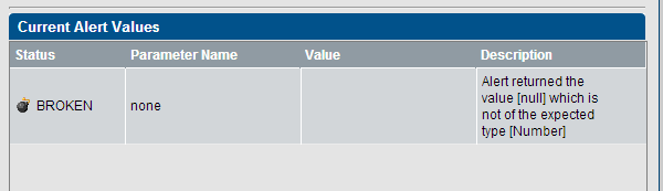

Note: The where clause below should be modified to look for data from the correct custom metric. To find out the name of the Deadlocks custom metric in your system, click on Options > Custom Resource Metrics and choose the Deadlocks metric. In the upper right hand corner of the next page you will see the metric name listed. Use that name in the where clause below.
select coalesce(sum(coalesce(md.v,0)),0) num_deadlocks
from CON_METRICS_NAMES_#DBID# mn
inner join CON_METRICS_#DBID# m on m.METRIC_NAME_ID = mn.ID
inner join CON_METRICS_DETAIL_#DBID# md on m.ID = md.METRICS_ID
where mn.NAME = 'CustomMetric-2'
and md.D >= CURRENT_TIMESTAMP - (#FREQUENCY# / 1440.0)
