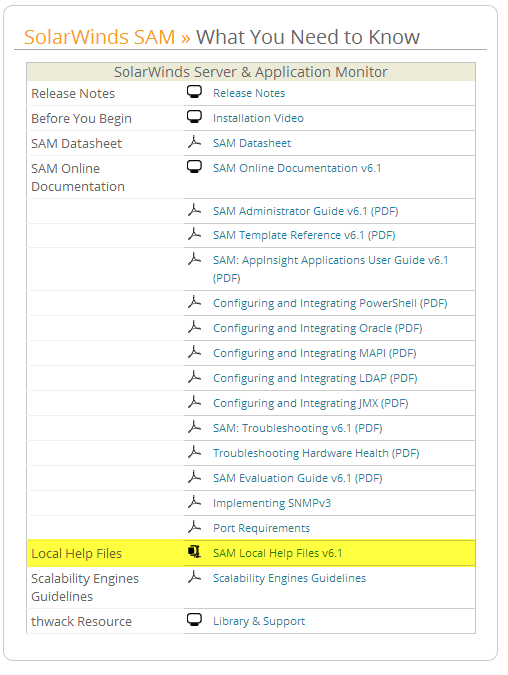

Michael,
Where can you get a more up to date version of the local help files?
thanks
jc
Hello, the location is still the same, only the zip package is being updated from time to time.
SAM's offline help files are located here -> http://www.solarwinds.com/documentation/apm/apmDoc.aspx
Sorry, the correct link is: www.solarwinds.com/documentation/apm/docs/SAMLocalHelp.zip
