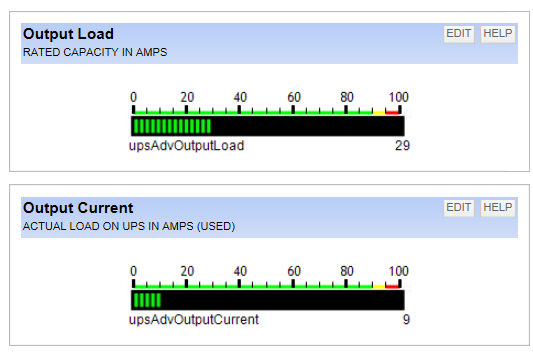

Reason being, our facilities guys that manage these said they would like a more proactive way to know the values specific to the 'individual' battery modules for 'Current Usable Watt/Hours' dips below a numeric threshold v.s. getting a threshold alert reactively regarding overall UPS aggregate capacity load as a whole, which I think is represented by the difference between 'upsAdvOutputLoad' and 'upsAdvOutputCurrent'

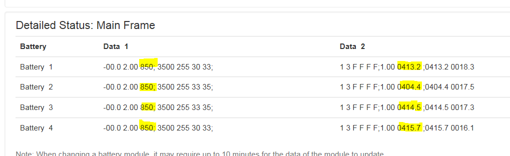

As shown in screen shot below, the highlighted values under Data 2 translate to 'Current Usable Watt/Hours' for EACH battery module at an individual level. Basically, we'd like to be able to pull those values to set up reporting, so if they fall below a certain minimum, say less than '400', they are flagged in a report to replace. The values under Data 1, show what that's relative to, '850' in capacity of the individual module, which is the 'Battery Pack Capacity' per Battery module.
So, I did an SNMP walk of the above UPS and can't seem to find/see 'Data 1' or 'Data 2', or the values nested underneath those?
