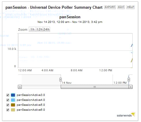

I have built a unDP of the Palo Alto Active Sessions OID of 1.3.6.1.4.1.25461.2.1.2.3
The data comes in a single row and each entry has a unique meaning (ex. %ofMax sessions, Max Sessions, ActiveTCP, ActiveUDP, ActiveICMP, etc)

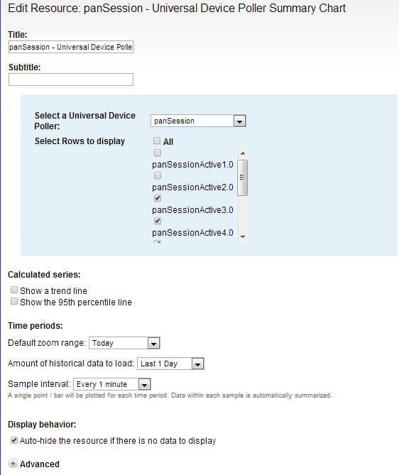

I don't see where I can apply unique labels for each entry, as it only provides an entry for the Table as a whole.
After the poller is build and assigned to a node, I am able to get the data streams from the entire table, however, I do not know how to uniquely label each data stream with its appropriate label. Am I doing this right or are there some quick fixes to get this cleaned up? Thanks, Scott
