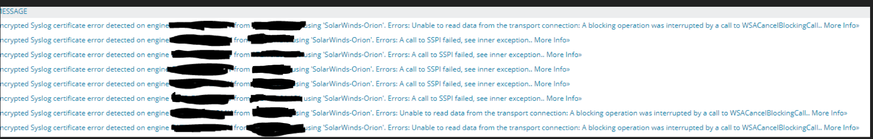

This is the error I am receiving (error attachment) .
We are only monitoring two of those nodes in SW though so lets look at those specific errors. "Encrypted syslog error detected on [polling engine] from [source] using SolarWinds-Orion (which is the server certificate). A call to SSPI failed. See inner Excemption"
