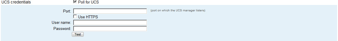

I have added my primary interconnect via SNMP in NPM.
I go in to edit the node and select the box "Poll for UCS"
Once I put in my credentials, the test fails. I have tried to "Use HTTPS" and it still fails. HTTPS is enabled on my interconnect. I have even opened a ticket and have not had any helpful feedback. Ticket number 346261
The documentation from solarwinds seems very sparse. I have reviewed the SettingUpCiscoUCS.pdf file and no help there. I have gone through the discussions here and have not seen a solution yet.
My username and password that I am using can get me into the CLI for the interconnect so I know that they are valid.
What else can I look at on the UCS side?
