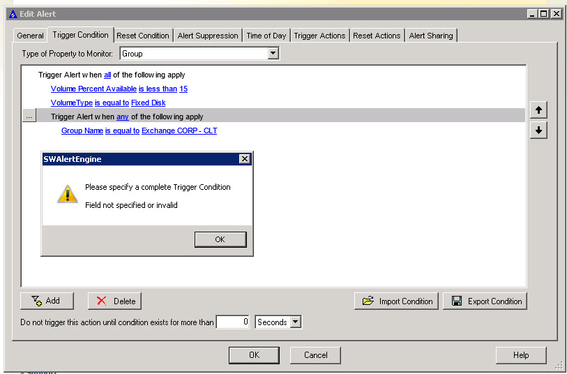

Hi,
I am trying to create an alert to only trigger when a disk is below 15%. I can do that but then I want try to trigger by group name and I get an error. I want the alert to trigger only for servers in a defined group.

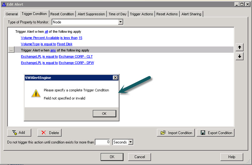

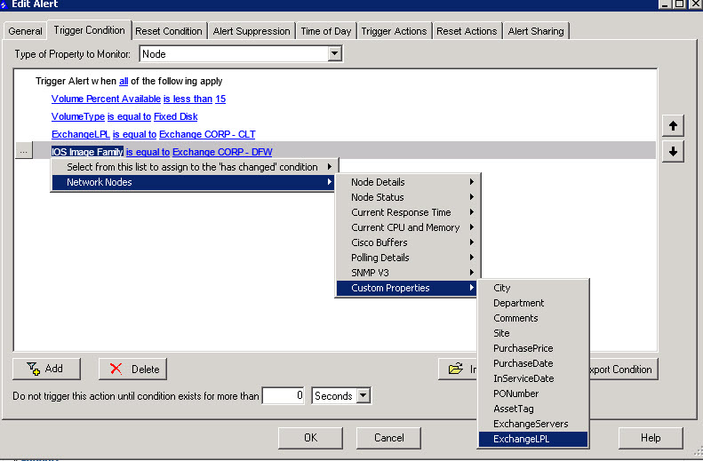

I see a couple of issues. You have changed the property monitor from volume to node just to select the custom property. leave it as volume. You still have access to the node properties.
Second - u need to choose the ... button to the left of the "any" condition group to add the simple conditions to the group. It looks like u went back to the top to add the simple conditions on the custom properties. All the conditions are at the same level - no indentation. See the comment on my first screenshot with this specific caution

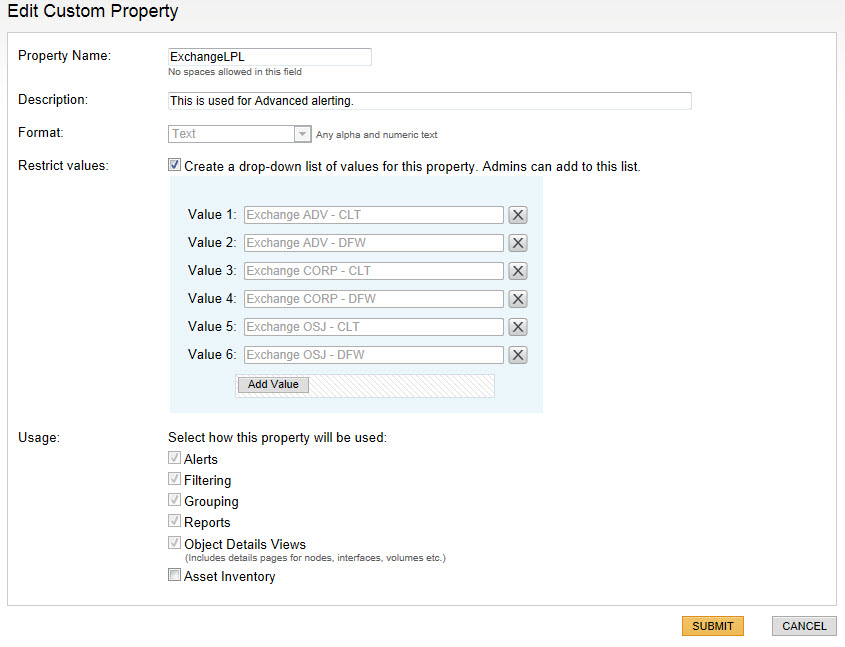

if the only reason you created that group was for this alert, then a Volume custom property route will do the trick.
If you want the group as well, then edit the group and for the 'add / remove objects' define a dynamic query based on this volume custom property rather than explicitly choosing the volumes

Custom properties is the most optimal route for this use case IMHO. Do this for 1 group, and I will provide additional instructions when I have access to a bigger keyboard to handle this in a single alert even across multiple groups ( even with different thresholds for each group)

You want to monitor a node or volume within a group. Keep the group argument, but change your property type to alert on.
Volume or something as such related to the values you are inputting.

Well I tried this and still get the same error.. Only way I can save it is choose type of property to monitor to volume and then it changes my custom property back to IOS image.
You have just become my favorite person!! That did it.
