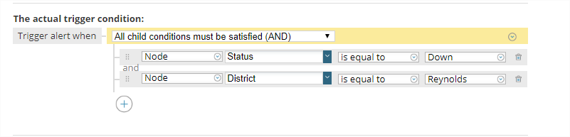

If you add a custom field drop down (other than Yes/No) and then create an alert that says "is not equal to" and use the drop down, the alert will not work.
In my case, I have a custom field called "District" and a drop down list with multiple entries.
When I set the alert up like this, it does not work:
Node custom properties:
If I remove the custom field from the alert, then it will trigger:
Initially support tried to tell me that development said this was expected behavior. They advised that you cannot use drop down lists (other than Yes/No) in alerts.
1) That's absolutely ridiculous
2) That's not true.
I changed a node to to have the district set to Reynolds
Then I change the alert to say if the district "is equal to" Reynolds send the alert
and that works
