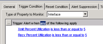

You can create an Advanced Alert so that if the interface traffic falls below a threshold it triggers. One thing to consider is that it is normal for WAN circuits to have very low utilization during off hours, so you probably want to filter this to business hours and buffer the alert by requiring a couple of polling cycles to complete before it fires. The latter is accomplished using the option to not trigger until condition exists for X minutes, where X is some multiple of your polling interval.
