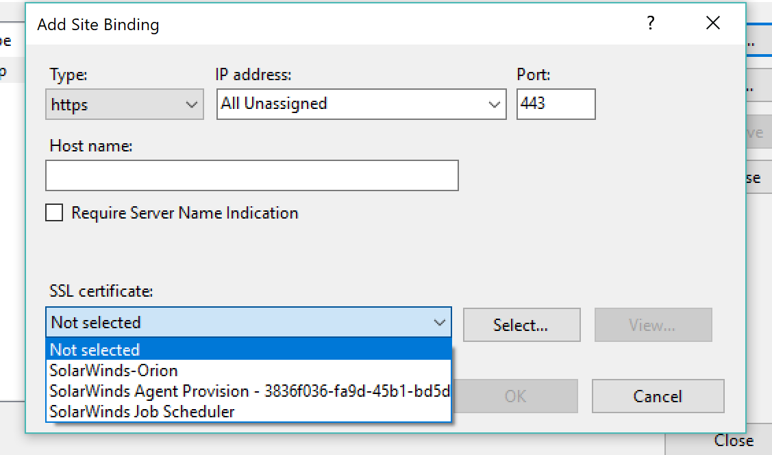

When using the "SolarWinds Configuration Wizard" to enable HTTPS for the Web console UI, there is supposed to be a drop down of "valid certificates" to pick from. I have imported a certificate to use, per the documentation, but there is nothing in the drop down list except "Generate Self Signed Certificate". The Wizard is acting like my certificate is invalid.

2. The new Config Wizard changes will not let you pick/see "invalid certificates". It appears the Wizard thinks my certificate is invalid so it's not allowing me to pick it

3. My certificate appears valid (to me
- It was imported into the "Local Machine" -> Personal certificate store. <- It should be the correct location the wizard scans in...
- It was just issued (an internal CA is issuing it) and is is not expired. <- It's not expired, but may not be trusted...
- The "Root" certification authority in the certificate is in the "trusted root certification authorities" in the MMC certificates snap-in (I validated the thumbprints) <- The certificate should be using a trusted certification authority, or I am confused about what is considered trusted
