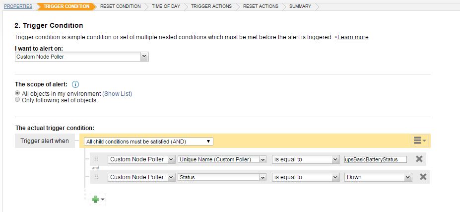

Is there a way I can create an alert for UnDP's that I created via the web-based alerting engine?
Yes, jacob.decker. On my end I used the Web alert manager to create a UnDP alert. See sample below:
