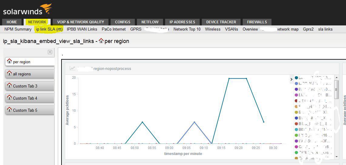

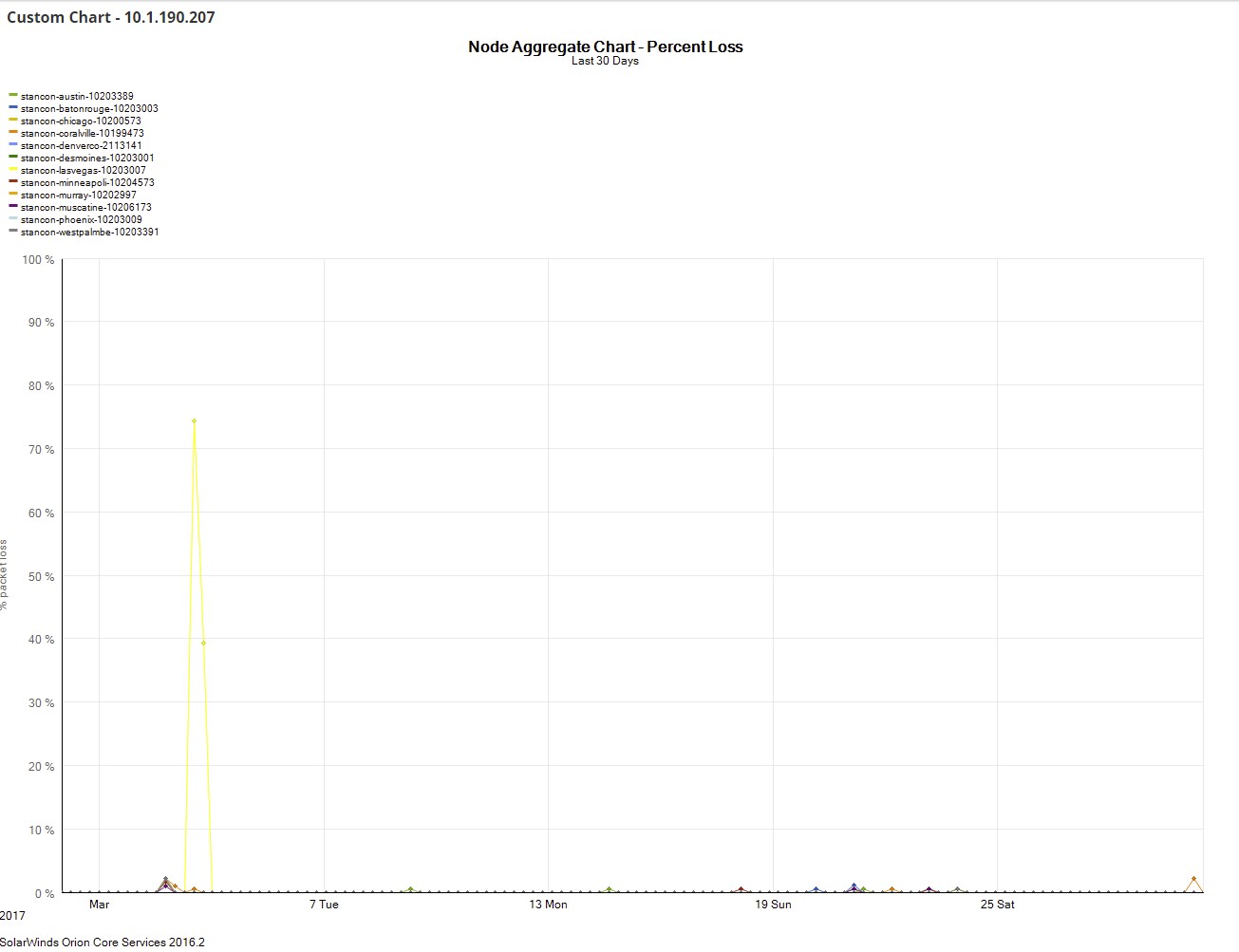

I want to monitor the packet loss in my network, and we're doing so through Kibana, integrated with SW via Orion web interface.
We had to shut down Kibana and now we either install the latest version and integrate it with SW again, or use SW alone.
The question is: can I monitor Packet Loss via SW the same way Kibana does? (each link separately, provides historical data as well),
as you can see in the image below:
1- Can I get something similar to this graph for PL using SW alone? (live monitoring + historical data)
If not, what's the closest thing I can get to measure PL via SW?
