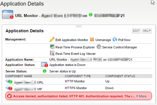

In my environment we have a SAM template with two component monitors - one is an HTTP and the other is an HTTPS. Both require domain authentication to access the IIS page.
When the preferred polling method for the SAM template is set to "Agent", you'll experience status flapping every few minutes which might trigger a ton of spam alerts.
First you'll see the status as shown below:

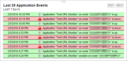

Wait a minute then refresh the page and you'll see the status go right back to "Up".
Wash, rinse, repeat. This will happen every few minutes, off and on 'forever'.
