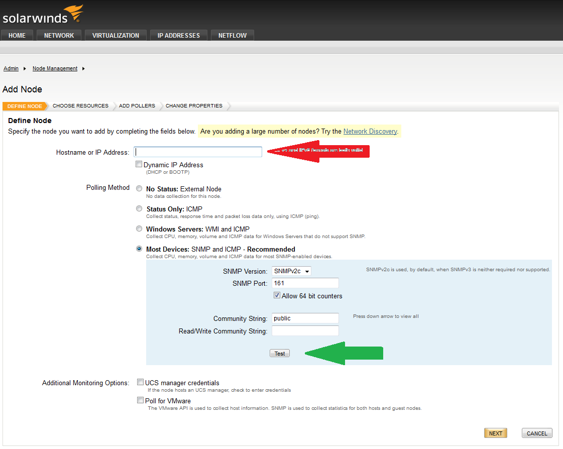

Go to Manage Nodes, then click on Add Node, and you will get this screen:
Put your IP address where the red arrow is pointing to, and click on the Test button where the green arrow is. If you don't get a successful message, then you need to check the connectivity between your Orion server and your device.
