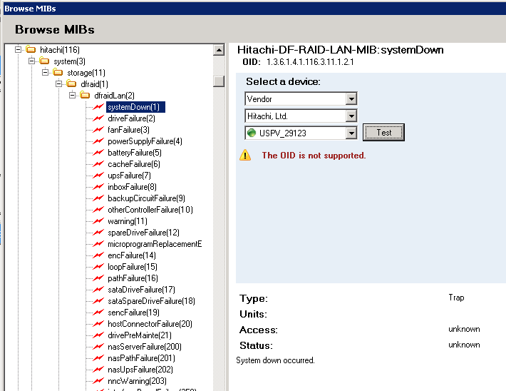

Its just an icon on Solarwinds UnDP which is linked to 'Type: Trap' OID's (this icon is not specific to a Vendor - any Vendor any OID that has a Type: Trap will have this icon associated to it on UnDP).
@Google for 'trap type oid'
Hope it helps
Ok, Then this OID just work for SNMP-Traps right? Thats mean I wouldn't make a SNMP-GET to a node with this OID.
Thanks in advanced for your help.!
Correct tavo.villanueva, trap OIDs are just referenced by the device sending the trap to Identify that trap. You don't "GET" them! (if you don't mind the game of words, hehehe)
