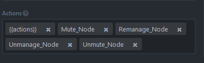

Actions - These are the actions that OpsGenie will show when you get an alert. Do each exactly as I type them. You should only have {{actions}} unless you added custom actions already. Uppercase and lowercase does matter here
Mute_Node
Remanage_Node
Unmanage_Node
Unmute_Node
It should look like this when done.

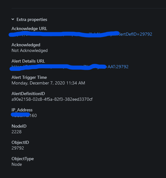

Next go to down to "Extra Properties" and add the following:
NodeID:{{NodeID}}
IP_Address:{{IP_Address}}
It will give you two fields. The first just put the name with no : the second field wrap it in {{}}

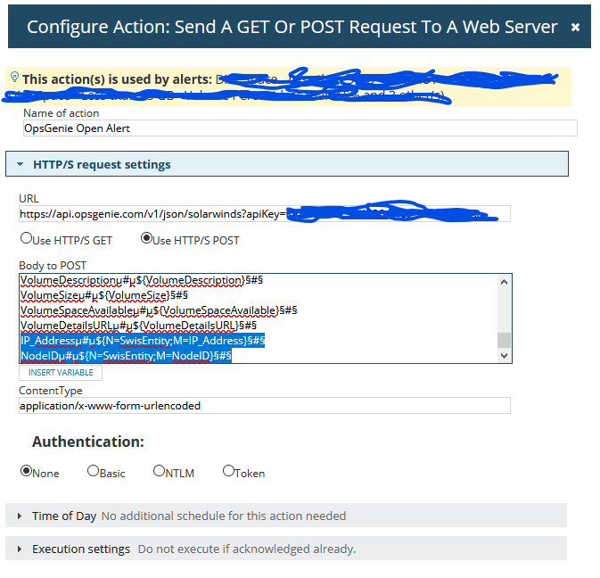

Solarwinds Alert Addition
We need to add the two variables to the post get open action for alerts. This sets the two variables up so OpsGenie knows what they are. Add this to the end of the "Body to Post"
IP_Addressµ#µ${N=SwisEntity;M=IP_Address}§#§
NodeIDµ#µ${N=SwisEntity;M=NodeID}§#§
This is the hard part completed. Fire off a test alert and if this is all correct you should see your actions (not workable yet) and you should see the IP address of the node and the node ID at the bottom under Extra Properties. If you don't see either one of thes stop and rego thru this.It should look like this towards the bottom of the alert
