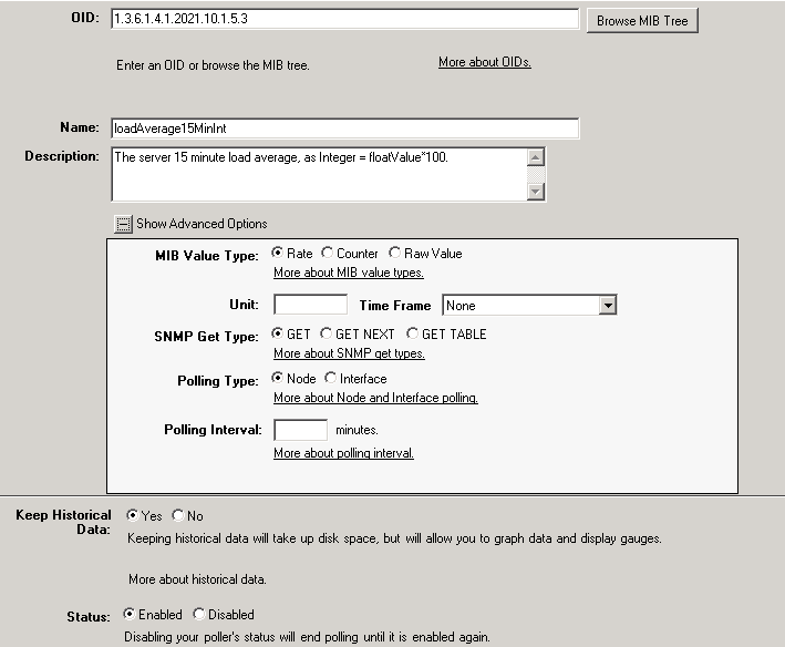

- Click on New Universal Device Poller
- Configure your UnDP as per the screenshot below. Note the name of loadAverage15MinInt -- this is an integer. We'll be transforming this result starting in step 4. The OID is 1.3.6.1.4.1.2021.10.1.5.3 for those of you who want to cut and paste. Click through the remaining screens as per normal (testing, assignment, etc.)
4. Click Transform Result.

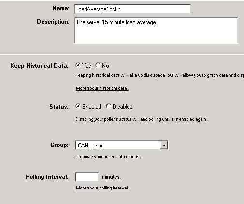

5. Name your transform loadAverage15Min (unless you want to name it something else, but just remember you'll need to change the name in the alert later in the process!)
6. Configure the transform as is shown in the screenshots below. You can name the group whatever you want -- but it is a good idea to group the UnDP and transform in the same group, at least in my mind.

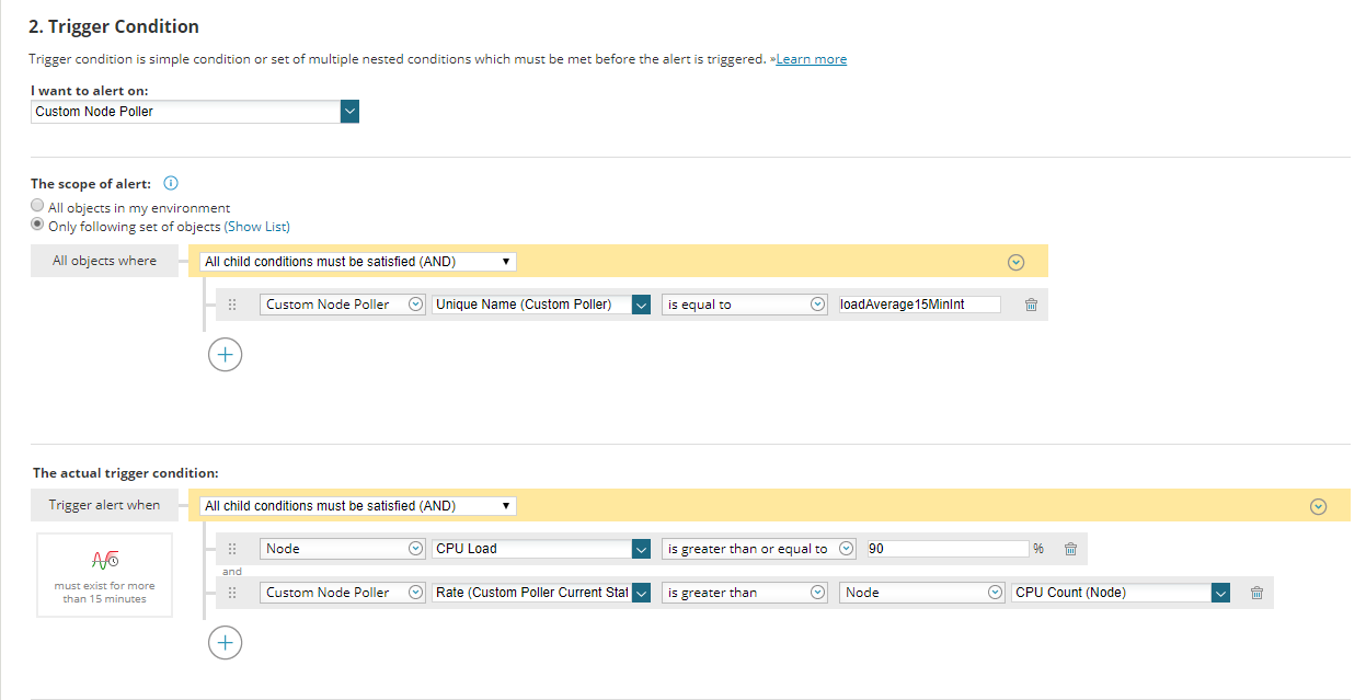

You've built yourself some Universal Device Pollers (15 minute and, if you are a keener, 1 minute and 5 minute) and the associated transforms. Now you are going to build an alert. This is going to be a custom SQL alert so remember that leaving the reset condition as a "when no longer true" isn't going to fly. You're going to need to build a reset trigger in SQL as well. The query is a little complex (and I did steal the hardest part from Leon's Utlimate CPU Alert post), but once you understand what it is up to it will all make sense.
1. Open up Advanced Alert Manager on your Orion Server. (If you are reading this after NPM 12 has been released some time in 2015, remember the olden days of non-web accessible alerts!?!)
2. Name your alert and set your evaluation frequency according to your standards. (You do have standards for that sort of thing, right?)
3. On the Trigger Condition tab select Custom SQL Query in the 'Type of Property to Monitor' drop down and then Custom Node Poller in the 'Set up your Trigger Query' drop down.
4. Selecting these values will pre-populate SELECT statements in the gray box. This is a good thing as there are a whack of table joins in there to make all of this goodness work. Copy and paste the code below in the white section of the trigger condition tab.

5. Set the 'Do not trigger until this condition exist for more than' to 15 minutes or so other value that is tied to your statistic collection interval. In our case, we poll our nodes every 5 minutes. This means that we have to experience this condition for at least 2 and up to 3 polling intervals for it to trigger.
