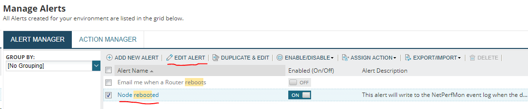

Hello.
Could you have a look at your alert settings please, especially the "reset condition" and the "trigger action"?
Default alert for a node reboot is to send an email and to create an event and it is set to be reset every 84 seconds.
Best regards,
Steffen

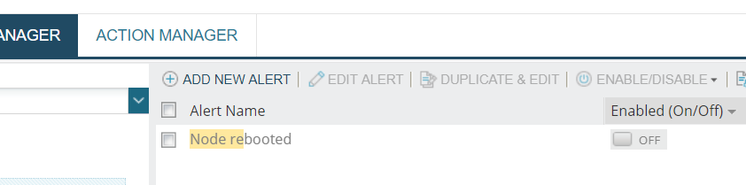

Hi Steffen
It's not en alert just event..
just event that keep telling that some box rebooted and keep sending that event many times...
Node reboot alert never got use in setup.

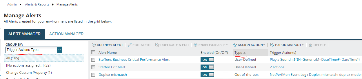

When the event is not being created by us* then it has to come directly from the device itself. Might be worth checking with the hardware vendor, maybe a firmware update will do the trick.
* you can check all your alerts that will create an event. Have a look at "trigger action type - Log to the NetPerfMon Event Log" and sort by "type - user-defined"
