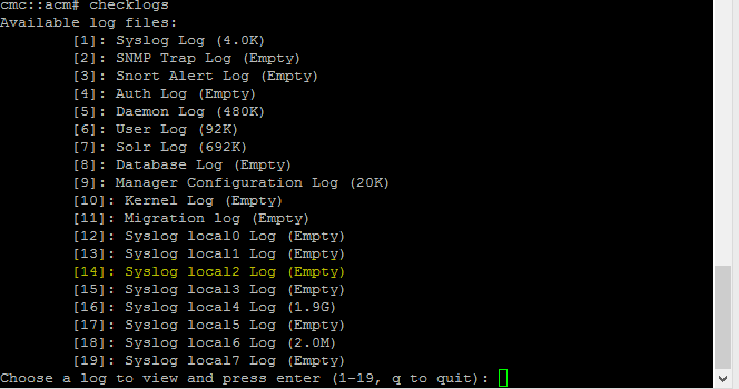

Step 1: Identify an unused Syslog facility in LEM
This can be done using the checklogs command. In my case, I determined local2 was empty

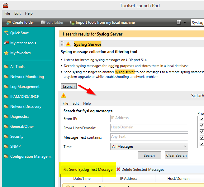

Step 2: Send a test Syslog message from Toolset to this facility.
This is done from the 'Send Syslog Test Message' button of the 'Syslog Server' tool in Toolset. The link is highlighted below
And verify that the message has reached LEM using the checklogs command mentioned in Step 1. The actual message you send here could be any gibberish. This step is simply to ensure there isn't anything blocking Syslog traffic between the Toolset and LEM

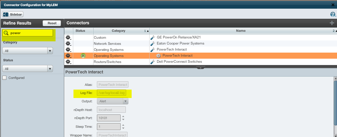

Step 3: Turn on a LEM connector to read from this facility's log
In this case, I searched from LEM's connector list and created an instance of the PowerTech connector to read from /var/log/local2.log
(assumption: you are familiar with LEM connnectors. If not, please refer to the LEM evaluation guide)

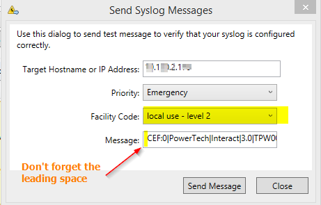

Step 4: Send a Syslog message from Toolset to LEM
A very important thing to note here is that you must insert a leading space to the message you copy. Also, note that I have chosen Facility Code as 'local use - level 2' which is same as saying ''Facility local2'

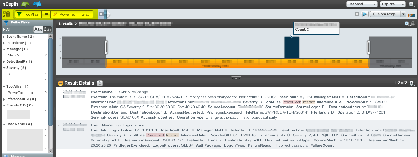

Step 5: See the normalized events in LEM (or not)
If the connector is able to handle this message and your Toolset IP isn't a managed node in LEM, you should see a message pop-up in the LEM console that 'New nodes were found' which you can click through (but not essential). You can then use your MONITOR view or nDepth search to see the normalized events
For the 2 messages, the corresponding normalized events look like below

And, it resulted in a UDPTrafficAudit event like below
One thing to note is that the timestamp in millseconds and the IP are prefixed by LEM's Syslog Server while saving the message into the /var/log partition (which is obvious when you see the output of the checklogs command as shown below).
