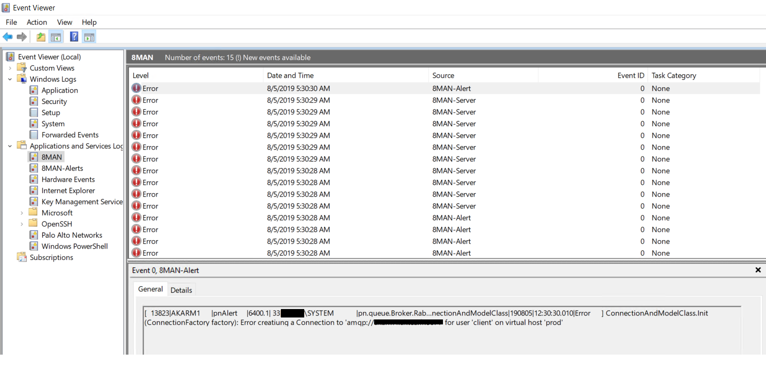

I have a recent problem with ARM and RabbitMQ.
My ARM server is Working fine, I found this problem in the Event Viewers but I have no idea where this message can come from?
Do you have any ideas ?

Hello Florian,
the message occurs when the tracer (AD Logga or FS Logga) likes to connect to the 8MAN / ARM server to port 5671. The problems is normaly the a firewall on the ARM server does not allow connections to the port 5671 or you can not make outbound calls from the client/tracer. Another reason could be that Rabbit MQ is not installed on the ARM server.
Sometimes you have a problem with DNS so that you need to use IP. Therefore you need to go to the installation directory of the ARM e.g. "C:\Program Files\Protected Networks\8MAN\etc" or "C:\Program Files\Solarwinds\ARM\etc" copy the pnServer.messaging.config.xml into C:\ProgramData\protected-networks.com\8MAN\cfg. then edit that is looks like this:

restart the ARM Service and maybe also the collector ARM service.
