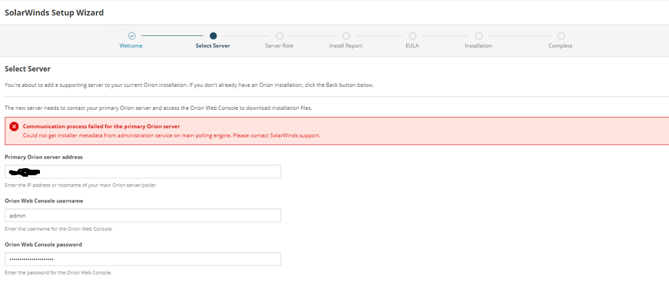

I'm new to SolarWinds. I just did a new install of SAM on a Windows 2016 server. I elected to install to the E drive instead of the C. Everything went fine without error and I can log into Orion without issue. We anticipated needing an additional ape because of the amount of monitors we need. So I setup another server in the same vlan as the Orion server to act as the ape. There is no connectivity issues between the two servers. When I run the Orion installer on the ape, select Add a Scalability Engine, add the requested information, and select next I get an error.

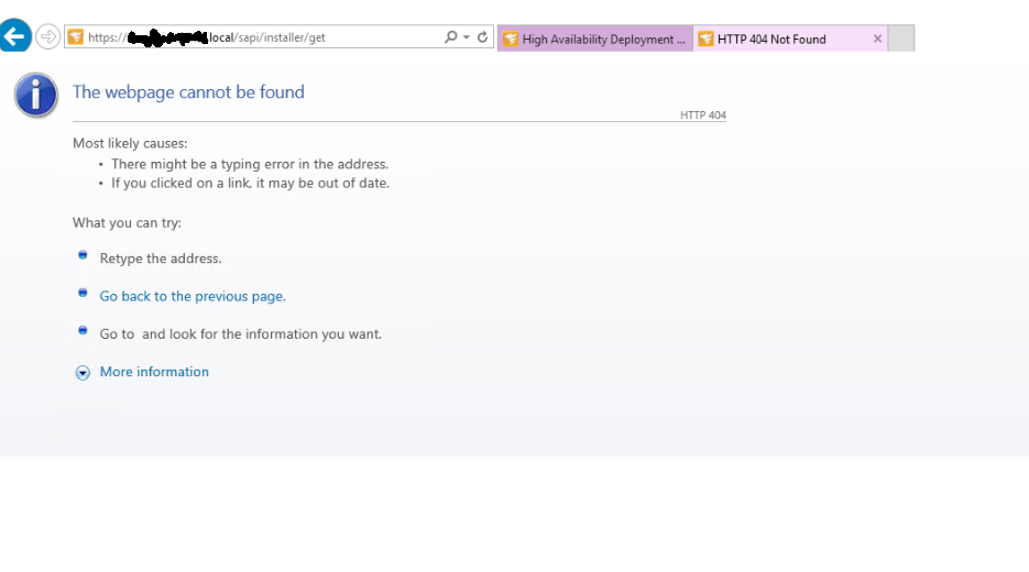

I additionally ran through the steps in this kb for installing an ape and that has issues also. I'm concerned that an out of the box installation is already having significant issues - https://support.solarwinds.com/Success_Center/Orion_Platform/Orion_Documentation/SolarWinds_Orion_Installer/Install_an_Additional_Polling_Engine_Additional_Web_Server_or_HA_server
