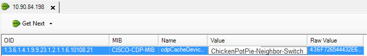

How about a universal device poller using OID 1.3.6.1.4.1.9.9.23.1.2.1.1.6.*

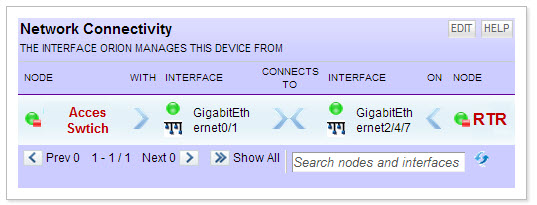

You could also in a round of bout sort of way also get the same information from the "Network Connectivity" resource, then you wouldn't have to write a UDP and you would also clearly have the interfaces they connect on. Where as with a UDP you get the interface OID's which can be cryptic if you have a lot of neighbors.
