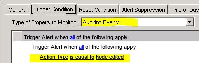

Type of Property to Monitor: Auditing Events ???
This is very very strange. From the trigger parameters it is quite obvious that this should trigger an alert, but it doesn't. Am I missing something? avn, would you please be able to confirm that the above does work in your environment?
OK, I did some tests - apparently this WILL trigger and alert if you will change custom property ITSELF (i.e. description, etc). However, sorry for not making it clear, I would like to receive an alert when VALUE of the custom property has been changed.

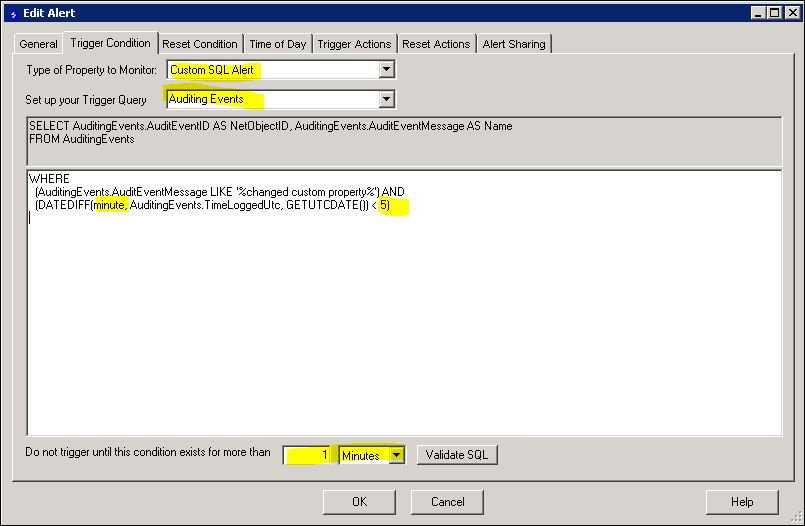

OK, I am answering first part of my own question. Below - is how to trigger an alert when value of the custom property changes.
The other question still remains:
How do I clear off alert straight away as soon as it has been triggered?
I see in this case only the following option: play around with time.
Script looks record over the past five minutes.
Type of Property to Monitor: Custom SQL Alert
Set up yuor Trigger Query: Auditing Events
last part of the script:
AuditingActionTypes.ActionTypeID in (24,25,26,27,29)
AND (DATEDIFF(minute, AuditingEvents.TimeLoggedUtc, GETUTCDATE()) < 5)
