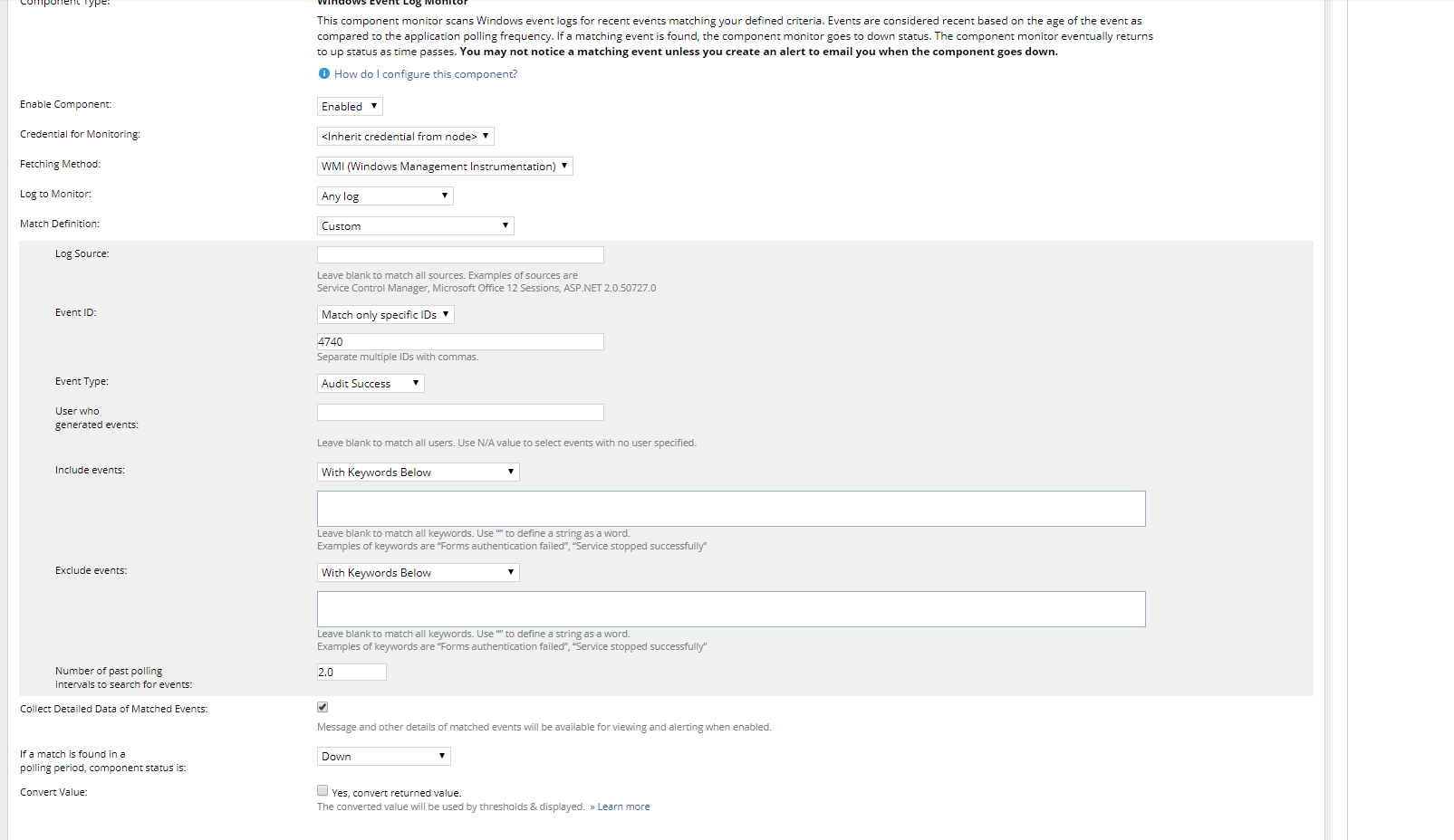

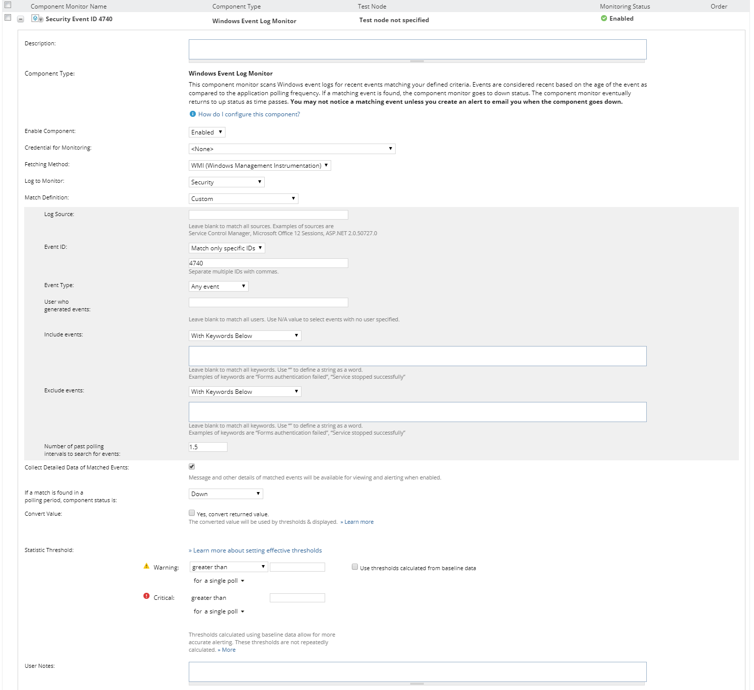

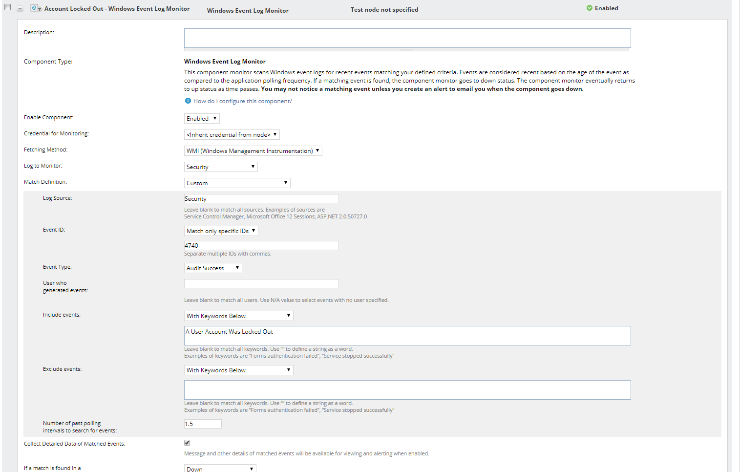

I setup the User Account lockout template to monitor the event log and to send out an alert when an account gets locked out. Below is the component monitor setup. I am spinning my wheels here trying to figure out why it is not working.
- I checked GPO and the policy is enabled to write this to a the security log
- The security logs flip every 30 mins or so
- I have searched for 4740 and nothing comes up
- We do have users that are currently locked out.
This should be easy but for some reason I can't get this. Maybe our logs are flipping too fast? Thanks!
