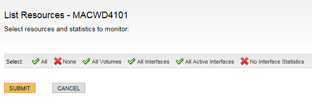

When listing resources for a server, it comes up with nothing. It had been working previously just fine. Any idea what might cause this and a fix?

Is the node managed by an additional polling engine?
things to test:
SNMP service running on node
SNMP configured on node with proper community string, accepting packets from the Orion host
SNMP community string is set in the node properties in Orion
SNMP connectivity between Orion and the node (i use SNMPtester on the Orion server)
make sure SNMP is allowed thru firewalls if present
if the node has multiple IP's, check SNMP connectivity against all IP's, you might be monitoring with the wrong IP
sometimes i have to uninstall and then reinstall the SNMP service on a node (Win 2008 mostly).

yes, what i have done was to change the poll metod and repair the job engine, job engine 2 and collector, that is how this works for me.
