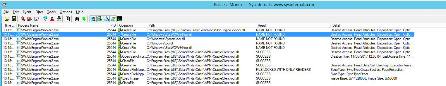

- I ran applications process monitor and got the following:
Following the advice of the document, it might indicate that I have the 32-bit version of lite client installed and am running 64-bit oracle.
- I logged on to the oracle server and ran tnsping, which revealed 64 bit Oracle.
