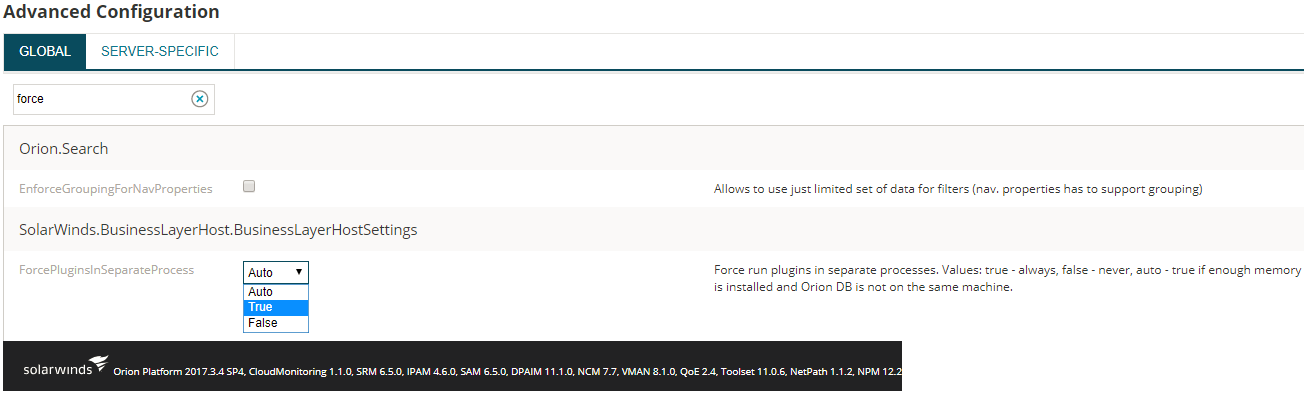

The advanced configuration settings editor pages are hidden and can be accessed via link:
- {OrionWebsite}/Orion/Admin/AdvancedConfiguration/Global.aspx - leads to “Global” tab
- {OrionWebsite}/Orion/Admin/AdvancedConfiguration/ServerSpecific.aspx - leads to “Server-Specific” tab

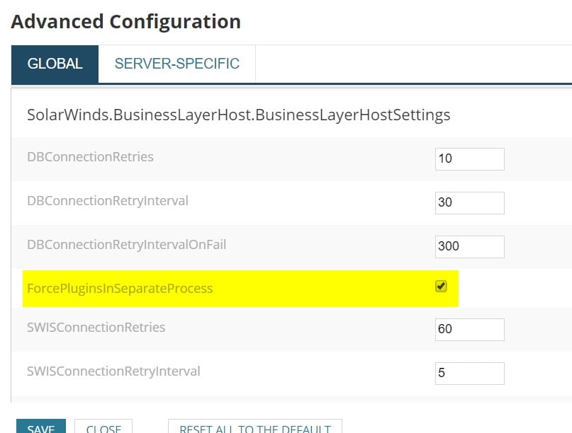

- Find ForcePluginsInSeparateProcess under SolarWinds.BusinessLayerHost.BusinessLayerHostSettings
- Set ForcePluginsInSeparateProcess to have a “tick”
You will then be prompted to restart the Orion Module Engine. This is safe to do, and should not affect any customer experience in the console.
