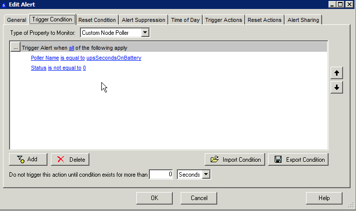

Hello All ,
Just wanted a second set of eye's
We have a bunch of emerson UPS and I have the UNDP set up
Set the alert up like this ...
Should work correct ... any pointers appreciated as well
Steve
To help narrow it down, let's take the "Status is not equal to 0" out of the equation. If you set it to "Status is equal to 0" does the alert fire?
yes when I changed it to is equal to 0 they all fire so in theory not equal to 0 should work when they switch over to battery - not sure why i didn't test it that way - thanks - DOH !

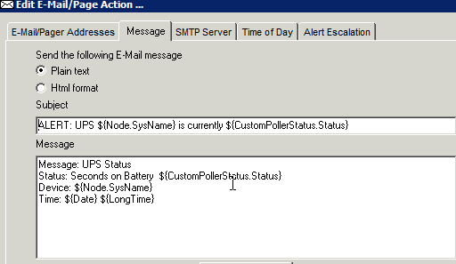

example-
Message: UPS Status
Status: Seconds on Battery 0
Device: nap-m1-UPS1
Time: 7/9/2013 10:26:39 AM

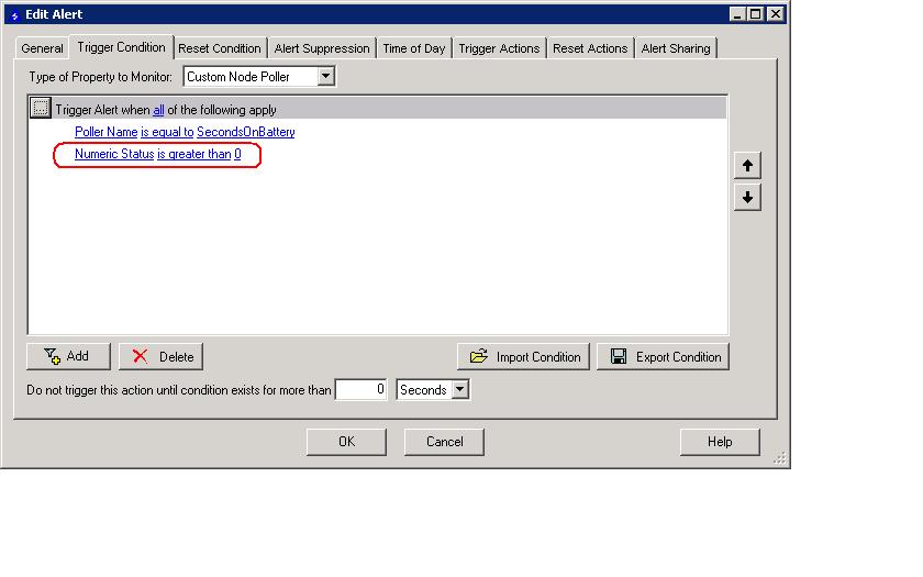

Try 'Numeric Status' instead of just 'Status'...
Dave
thanks for the pointers all - really appreciate them as I suck at setting up these alerts .. I know what I want but when i get to the variables and statements I get a brain fart sometimes ..
