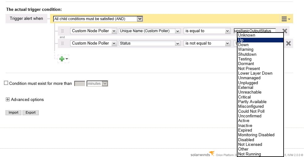

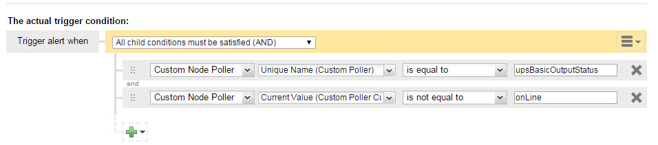

Wondering if anyone has had experience with setting up a custom alert for APC UPS using a Universal Device Poller (specifically upsBasicOutputStatus).
The upsBasicOutputStatus currently has a status of "onLine". What I would like to do is be alerted when this changes. All forum posts seem to answer the question with the old Advanced Alert Manager.
When I try to add a status "not equal to" - there only seems to be pre-set responses that don't include "onLine"
Anyone know the proper way to set this up? Thanks!
