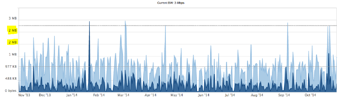

We are running into an issue with web report charts, when referencing peak transmit and receive bps.
Notice the duplicate "2 MB" entries. This happens any time it should reference a fraction of a MB for example 2.5 MB or 1.5 MB, and so on.
We have reported this to support and they agree this is what's happening, the work around suggested to use an alternate measurement such as kbps.
This issue is now being forwarded to engineering group. However, I believe this is an actual problem and shouldn't be treated as a feature request.
I'm hoping to get a feel for how many of you out there are experiencing the same issue?
While we could use a "raw" measurement, this as some of you may know, not going to fly with management.
