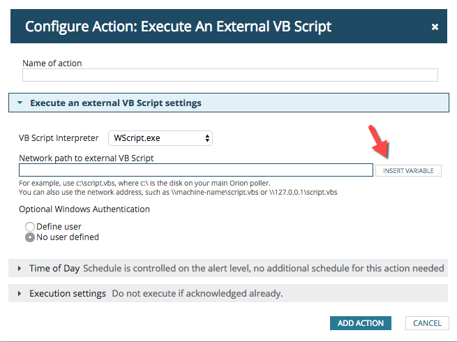

You can most definitely pass variables to your vbscript as shown below.
I realized that after trying it. You're reply didn't mention that and I assumed it meant you had to create a custom script to figure all of that out.
