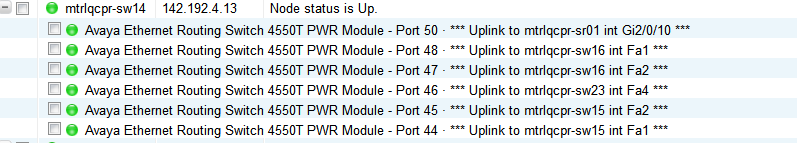

IN SW, this is what it reads:
Now this is where it gets weird....a site like Montreal, switch 14 as an example, has the interface names correct as well as the elements listed properly. Both are the same device type - 4550T-PWR, both running the exact same code. Both of the devices have been removed and added multiple times, and it works fine on this device.
(config from the Avaya)
43
44 *** Uplink to mtrlqcpr-sw15 int Fa1 ***
45 *** Uplink to mtrlqcpr-sw15 int Fa2 ***
46 *** Uplink to mtrlqcpr-sw23 int Fa4 ***
47 *** Uplink to mtrlqcpr-sw16 int Fa2 ***
48 *** Uplink to mtrlqcpr-sw16 int Fa1 ***
49
50 *** Uplink to mtrlqcpr-sr01 int Gi2/0/10 ***
And oddly enough, SW clearly sees this as the proper resource:
