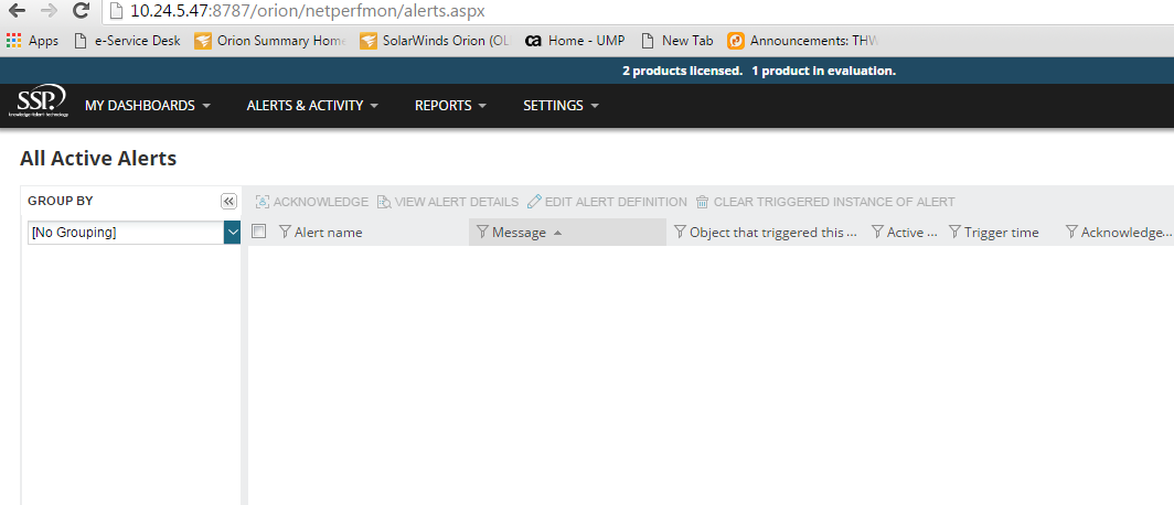

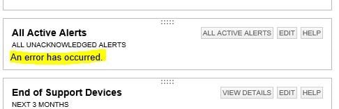

I'm having a problem with alerts. alerts can be triggered when there's an event., but in the "All active alerts" window I don't see anything, its blank. in the Home window under all active alerts, it says: An error has occurred.

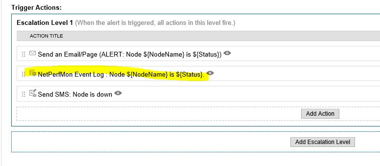

Sounds like you might need to add an additional Action to your trigger actions.
Edit your alert >select Trigger Actions > Add Action > select 'Log the Alert to the Netperfmon EventLog'
if you can share a screenshot of the 'An error has occurred' should give perspective

NetPerfMon is already added for all alert trigger actions. (see attached screenshots). active alerts used to be shown in the all active alerts window as normal. its only recently that I'm seeing this kind of issue. I don't know why this is happening now, or what caused it to stop working as the error is not that detailed.

Hi, I facing the same problem with alerts. alerts condition is in event details but in the "All active alerts" window have blank screen in the Home window under all active alerts is also blank.
Please any one have clue on this issue.

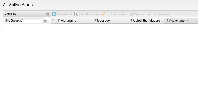

I am experiencing the same problem... my active alerts window is empty and i'm not getting any alerts via email.

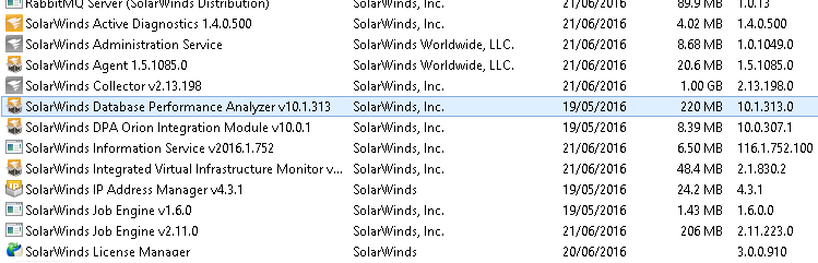

Do you have DPA installed on the Same box as SAM/ NPM/ Etc?
Shane
Yes I do at the moment.
What version of DPA are you running?
- Log into the server > Control Panel > Programs & Features and over to the right there should be a version number?
version 10.1.313.0
An issue prevents integration between DPA and Orion 2016.1 from being installed on the same computer. A new system identifier must be generated for the DPA integration service.
- Are you under maintenance? Please create a ticket and give me the ticket number and I will work on this with you.
This is a known issue. It occurs when DPA is installed on the same server as Orion 2016 ... We have a work around.

Yup, I'm 99% sure this is your issue. I had same issue yesterday. The integration breaks alerting in the way you have screenshots above.
