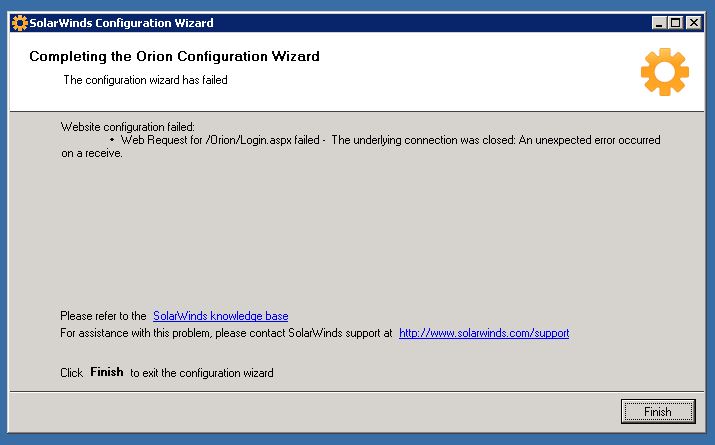

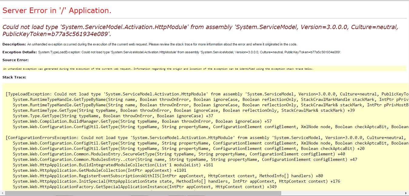

Earlier today one of my technician's installed Mobile Admin (trial version) to see how well it would work. The installation was done on the same server running SAM 6.2. Later, I discovered that the SAM portal was no longer accessible, with the following screenshot showing was loaded when i attempt to access the portal:
I uninstalled Mobile Admin and had no luck. My supervisor recommended I run the Configuration Wizard and to repair/re-install all the components. At the very end, I had this error pop up:
Does anyone have any idea of what configuration/setting I need to modify to make SAM portal page accessible again?
